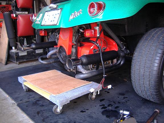

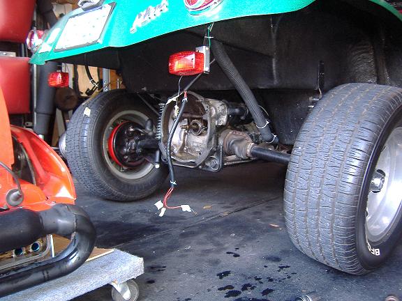

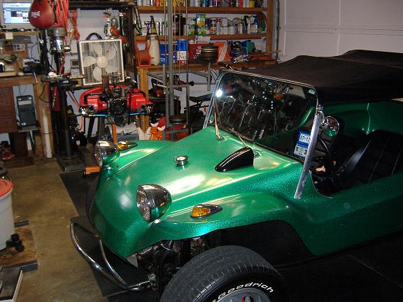

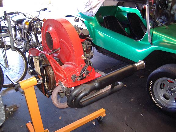

It happened! It was so nice out on Saturday, February 3rd, that I put about 50 miles on my buggy. While enroute back home from Kemah, a loud clicking started. No loss of horse power, but loud enough to believe that I had blown a hole in my exhaust. Got home and shut it down. Looked for holes but could not find any. Started the engine again and it ran smooth but still had the loud click! I could hear it coming from No.1 and thought it might have been a valve gone out of adjustment. Then it happened! It stopped! I put a wrench on the pulley and tried to turn the engine a complete cycle. It would stop and I could hear metal-on-metal near no.1. I took the valve cover off and saw that no.1 valve was not moving. I have pulled the engine and too start my investigation. It is 50 years old and I have gotten about 3000 miles out of it since bringing it back to life! Pics for you guys to enjoy.

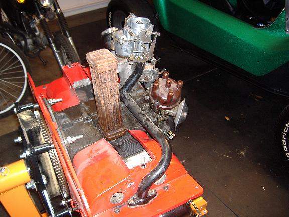

More Pics
Engine Out 2.JPG (64.75 KiB) Viewed 31209 times
Clutch Removed.JPG (76.14 KiB) Viewed 31209 times

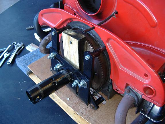

Adapting for Engine Stand.JPG (67.24 KiB) Viewed 31209 times

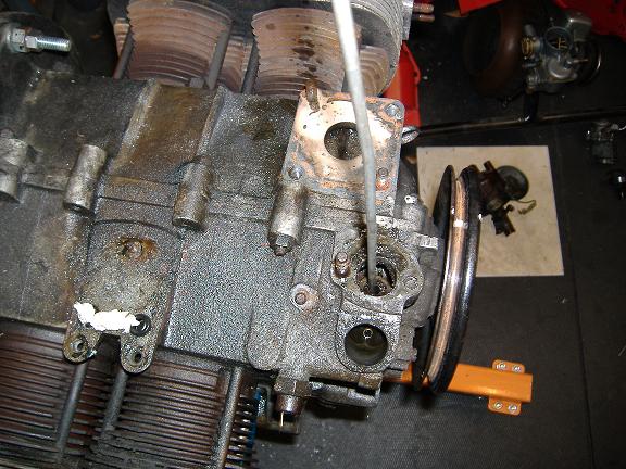

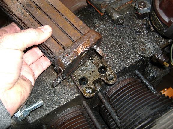

Started the tear-down of my engine and found some interesting problems. An oil leak I was contributing to bad push-rod tubes was actually dropping through the block from the oil cooler. Nothing bad, just drips, but the oil sure made its way across the block. The second problem I found was that the plastic cone which houses and guides the push rod for the fuel pump is broken in half inside the block. I tried to build a tool to pull the bottom half out but I was unsuccessful. I also thought you guys would get a kick out of my Bosch distributor with a bake-lite cap. Now that is old school! Pics for your viewing pleasure.
Coming Apart, Oil Leak Detected.JPG (67.9 KiB) Viewed 31163 times
Oil Cooler Leaking 2.JPG (84.96 KiB) Viewed 31163 times

Fuel Pump guide broken in the block!

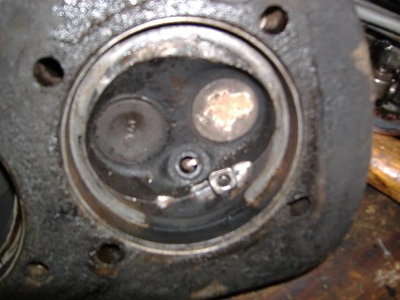

Well, found out what the loud clicking was! It wasn't a lifter, lifters are OK. Somehow, from somewhere, a small square nut moved into the cylinder and the no.1 piston was smashing it into the head. Lucky though, minor damage and no valve damage. Cannot imagine where it came from! Air cleaner? carburator? who knows! Pics of my pain for your viewing pleasure.

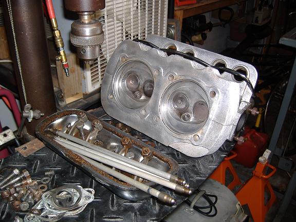

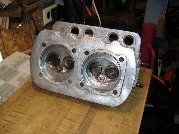

That object found in the cylinder was a small square nut. Looks like it was in there for a long time. Maybe even smashed into the head for a long time. The nut is rounded and smooth like it has been through a rock tumbler. I was able to get the fuel pump debris out of the block using a slide hammer (dent puller) which threaded nicely into the broken part. There may still be some debris in the block but I believe that it will move to the oil screen. I got one head polished and I am working on the other.
Start Polish.JPG (76.29 KiB) Viewed 31120 times
Polish Done.JPG (61.41 KiB) Viewed 31120 times

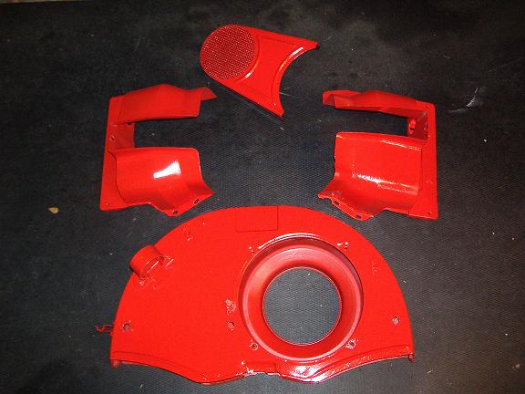

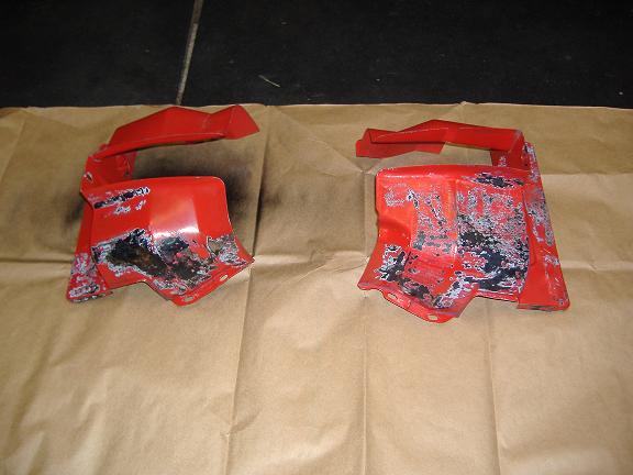

Waiting for parts so I thought I would freshen up the tins a bit!

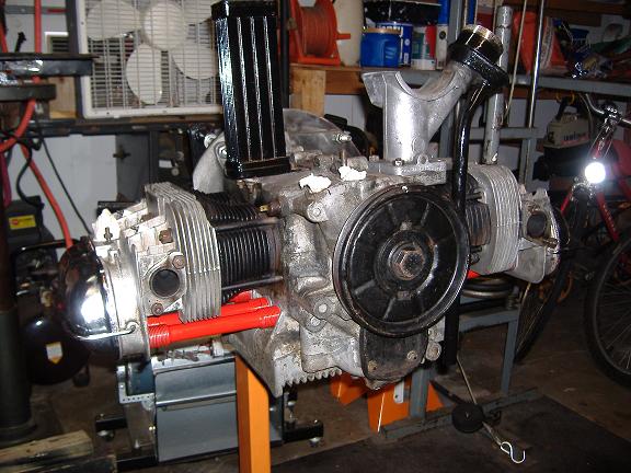

Postby johber41 » 14 Thu Feb, 2013 2:39 am

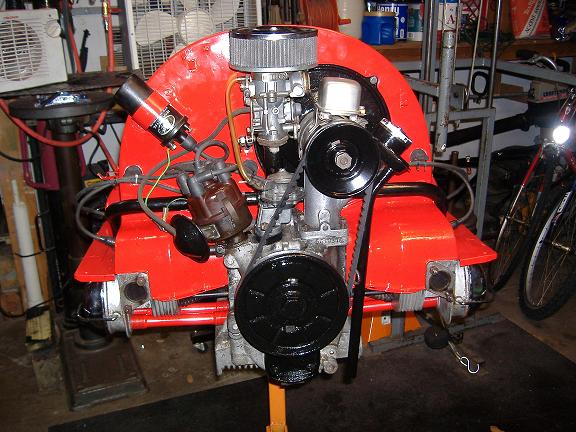

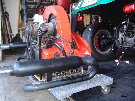

Thank you sir! I spent the good part of my evening reassembling the engine. No big changes besides the polishing and some new seals and push-rod tubes. I am anxious to get the thing started. I am hoping there wasn't any collateral unseen damage to the internal stuff like the crank, piston rods, cam shaft...etc. We will see! I want to spray my mufflers with high-temp flat black paint and then get the car moving again. I am having buggy with drawls!
Reassembled 1.JPG (79.93 KiB) Viewed 30865 times
Reassembled 2.JPG (77.66 KiB) Viewed 30865 times
Reassembled 3.JPG (74.91 KiB) Viewed 30865 times

Postby johber41 » 18 Mon Feb, 2013 11:38 pm
Ready for Installation. Have my fingers crossed that it will run! I do not have a second bell housing to set up a run on the stand, so, I will have to slip it back into the trans and see what happens. I had a local bug guy tell me that I am running too light of an oil (10W-30) for an engine that old and he told me that I need to use 20W-50. Does anyone have any ideas about that? They told me that the tolerances in the older engines are loose and that the 10W-30 oil turns to soup pretty quick as this engine will beat it like a mixer.

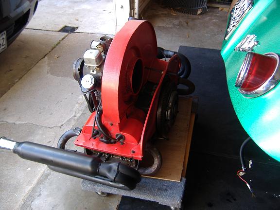

Postby johber41 » 21 Thu Feb, 2013 11:37 pm

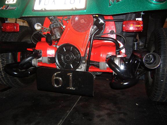

Back running again! Wow....no oil leaks! A big lesson learned after assembly. I put the distributor back into the block and secured it without checking to see which way the rotor was pointing. I tried to start the thing and got some back firing. Of course, I thought that the cam had jumped timing or something as horrific as a bad lifter or a blown valve! I looked at my 1973 VW manual and watched an internet video. I saw that the rotor should be pointed in the direction for the plug wire for cylinder #1 on the cap when the crank is at TDC. Lesson learned! Did the light bulb timing and now it runs great!
Running again.JPG (70.5 KiB) Viewed 30847 times

Postby staggerwing » 22 Fri Feb, 2013 9:17 am
Yay! Back on the road again! Awesome! Thanks for keeping us up to date on yer progress.
"No leaks"? You better check to make sure you have a VW engine in there.
