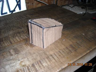

I am going to use the bad weather to go ahead and finally install a roll bar. I know that the wife and daughters think it is a good idea. Found a decent home-made roll bar on the Samba which was assembled by a guy in College Station that knows a lot of you guys in the club.
Roll Bar Project 1.JPG (63.63 KiB) Viewed 29200 times
Need to Make this out of steel.JPG (59.95 KiB) Viewed 29200 times
Cardboard Pattern 2.JPG (64.24 KiB) Viewed 29200 times

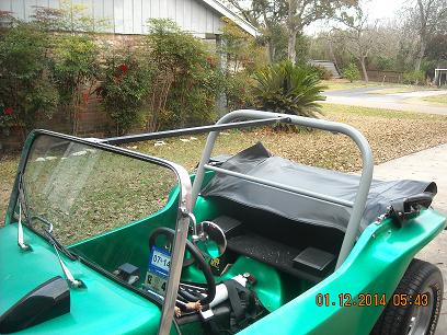

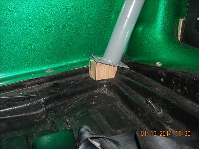

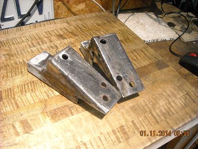

Postby johber41 » 12 Sun Jan, 2014 12:26 am
Thanks Brian, I had to fabricate mounts that matched the rounded edge of the rear pan. They turned out better than I expected just a lot of cutting and MIG welding, grinding. I was also lucky I found an old metal support from a hide-a-bed that I was saving. It will be the perfect tie-in to the windshield after some more cutting and welding.
pics attached
New Mounts.JPG (69.99 KiB) Viewed 29179 times
New Mount 2.JPG (68.27 KiB) Viewed 29179 times

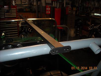

Postby johber41 » 12 Sun Jan, 2014 7:51 pm

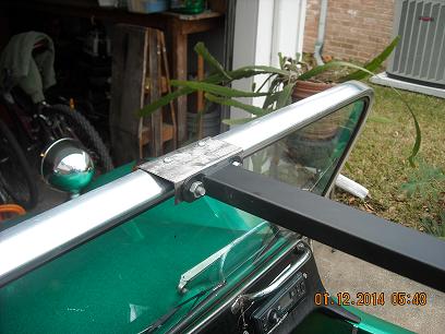

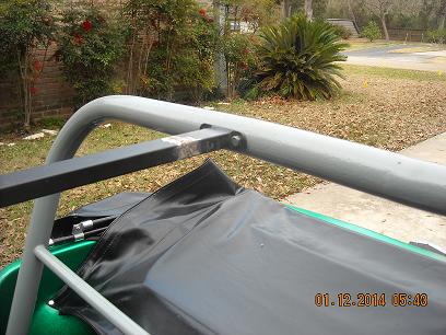

Got the fabrication done and I am a little disappointed with the thickness of the bed-frame part I used to tie the roll bar to the windshield. I may copy that later in a heavier metal. Now I need to tear it down, paint it , and re-assemble it and I may tack weld the mounts to the pan even though the bolts are giving it plenty of strength. I need to add some plate steel to the bolts underneath the car for some added strength. The roll bar that I am using was designed for rail with bolt-up or weldable connectors fabricated on the back of the bar to receive two down supports. I was going to grind the connectors off, but instead, I might throw some extra stop lights in them. The windshield mount was an easy build, cut from some 4 " rectangular tub steel and pinched in the front so that the windshield can receive it like my convertible top.
pics added
Mock-up 1.JPG (75.72 KiB) Viewed 29155 times
Roll Bar Tie-in Closeup.JPG (68.4 KiB) Viewed 29155 times
Windshield Tie-in Closeup.JPG (65.33 KiB) Viewed 29155 times

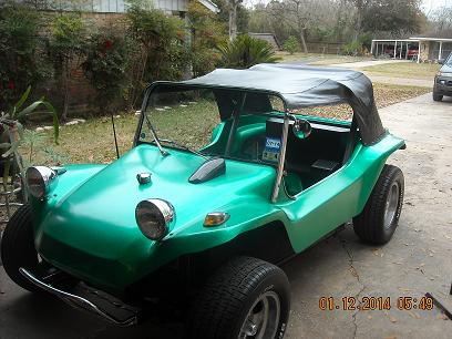

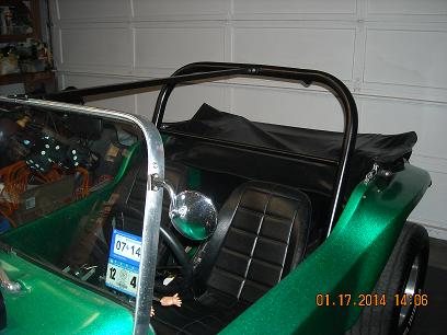

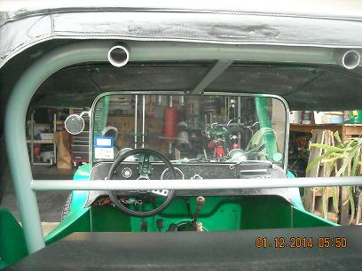

Postby johber41 » 12 Sun Jan, 2014 11:37 pm
I thought of that Chris, but I have so much going on behind my seats. I have a harbor freight trailer tongue tool box for a trunk and its a place for my convertible top to fold onto and to be snapped down. I have the down tubes, but they are bigger than I would have made them. I understand that the builder intended the setup for a sand rail, not a manx style buggy. The whole set is made of very heavy steel, at least schedule 40. The hoop however is working out for very well for my car with my top folding over and clearing the whole configuration.
Conv Top Fits Perfect.JPG (61.38 KiB) Viewed 29148 times
Conv Top from rear.JPG (65.29 KiB) Viewed 29148 times
Top Coverage from front.JPG (67.87 KiB) Viewed 29148 times

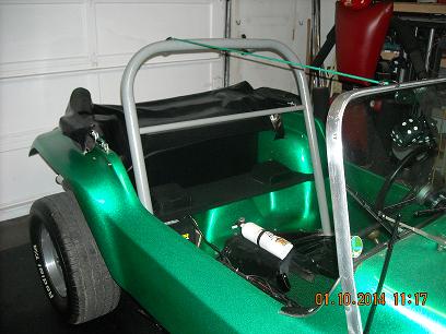

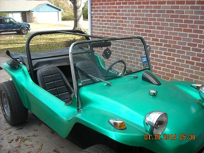

Postby johber41 » 18 Sat Jan, 2014 5:39 pm
Done...for now!
Done 2.JPG (61.59 KiB) Viewed 29117 times
Done 1.JPG (70.53 KiB) Viewed 29117 times

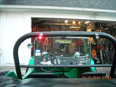

Postby johber41 » 20 Mon Jan, 2014 6:40 pm
I wired up the roll bar to use the down-tube connectors as turn signals and brake lights. turned out to look pretty nice and it gives me more visibility with other drivers.
Roll Bar Wired Up.JPG (67 KiB) Viewed 29069 times
Re: Time for a Roll Bar
Postby ScottR » 21 Tue Jan, 2014 1:15 am
Looks great. How did you find the lights so fast...and they look like they fit like a glove.
Posts: 197
Postby johber41 » 21 Tue Jan, 2014 12:14 pm
I had them in my parts storage...I purchased them on-line for an old 1965 honda s90 motorcycle I rebuilt and they were 6v. They did not fit the application for the bike so I just held on to them. They are LED and they were just shy of fitting into the connectors so I shoved them into a piece of handlebar rubber and they push in nice and snug. Really got lucky I had the parts and that they fit like that. Thanks Scott!
