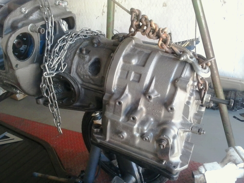

Postby malooga » 23 Mon May, 2016 4:31 pm

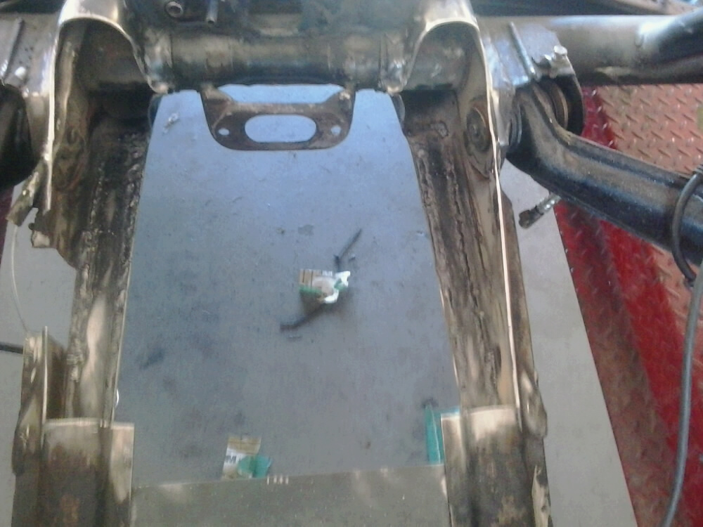

Had to put a 13in wide object into an 11.5in wide area.
Found this trans in Cali and it only has about 15k miles on it.
Came out of an 86 Vanagon.

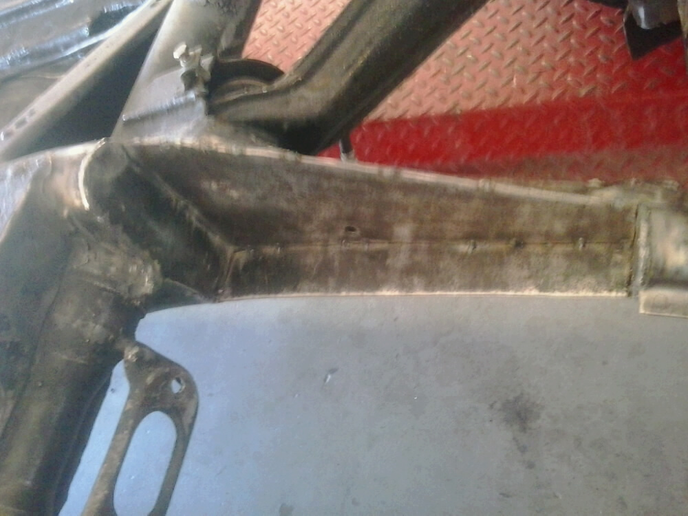

Postby malooga » 23 Mon May, 2016 4:33 pm
Had to really carve up the horns to make it fit.
malooga
Posts: 16
Joined: 14 Sun Nov, 2010 12:00 pm
Re: New project
Postby malooga » 23 Mon May, 2016 4:38 pm
I'm sure I'll get some sort of "you can't do that to the horns remarks".
We boxed them back in and added some support back to it. There is a 3\16 flat bar on the inside
of the horn and we used the same gauge of metal to cover that piece and fill the sides. There is also
1" angle iron running the length of the horn going past the torsion bars a bit as well for added support.

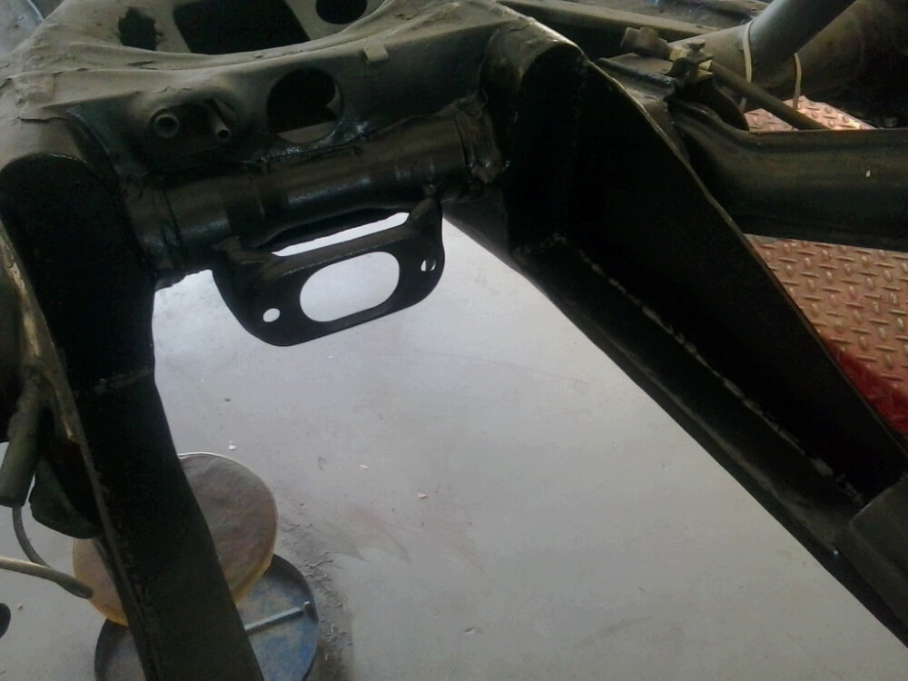

Postby malooga » 23 Mon May, 2016 4:41 pm
All cleaned up it looks pretty good. we have had the motor and trans mounted and it worked
out great. We had some other issues that forced us to pull the trans and motor back out and fix.
I'm buying new torsion bars and spring plates as well.
