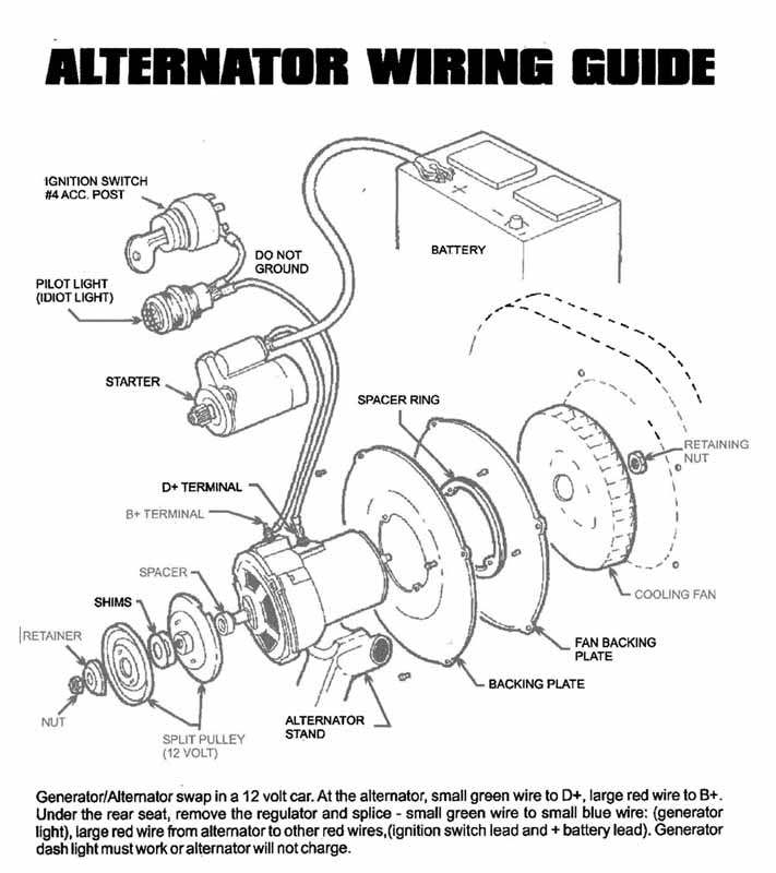

Postby Jack Duncan » 16 Mon Mar, 2009 10:24 pm
My question pertains to the indicator light that excites the alternator. (It doesn't excite me that much.) Does the light have to be installed in the circuit that goes to the alternator or can it be anywhere as a draw on the 12v system? My guess is that it is installed in the wire to the alternator.
Someone give me an answer please. :? :?:

Postby Ken » 17 Tue Mar, 2009 8:11 am
Click anywhere on picture to enlarge.... Hope this helps

Postby Bryan Porter » 17 Tue Mar, 2009 8:58 am
Ken you want it where you can see it as it will tell you if you lose a alt. belt and that could save you a engine.

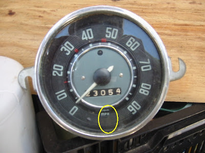

Postby Ken » 17 Tue Mar, 2009 9:25 am
I agree 100%. I use the turn signal lamp in my speedometer. Comes on when main power key is on and off when alternator begins charging. The lamp is then available for turn signal use.
Bryan Porter wrote:Ken you want it where you can see it as it will tell you if you lose a alt. belt and that could save you a engine.

Postby Jack Duncan » 17 Tue Mar, 2009 9:38 am
Thanks guys, you told me exactly what I needed to know. Now I can get back to work. :D
