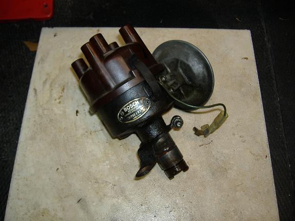

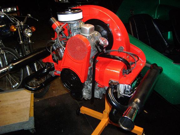

Postby johber41 » 13 Wed Mar, 2013 7:52 pm
Thanks for the sheet Greg...that is how I read it, but Russ you are on to something. I do not have a 009 distributor and all of the "how-to" videos I have been watching do include that model. I statically timed the engine to 10 degrees BTDC and then I figured out how to utilize my 12V battery charger for a power source for my 70's model Sears timing light, my car is still stock 6V. Russ, I believe that you are correct because when I put the timing light on it, the distributor, old Bosch with a bakelite cap, big vacuum advance module attached, (see pic) immediately takes the mark to 30 degrees BTDC and the thing runs great. When I pull the vacuum advance hose from the distributor, the timing goes back down to 10 degrees BTDC. In the videos, the mechanic has to rev the engine to get the 009 distributor go to 32 degrees BTDC. I am still learning, but the lesson here for me is that the vacuum advance sends the timing to the needed setting right after start up. Does that sound right?
Thanks guys!

Re: 1200 cc Timing
Postby johber41 » 31 Sun Mar, 2013 12:11 pm
Found out that my Solex 28 PIC carburator was leaking significantly at the main throttle bushings. With this in mind, the vacuum advance issues I was having when trying to time my engine were likely due to the carburator leak. I have replaced it with a 30 PIC and what a difference. The timing is now accurate at 10 degrees BTDC at idle with the vacuum advance moving to about 32 degrees BTDC at maximum advance. Someone asked me why I did not change to a 32 PIC or even a 34 PIC and I explained that I am running a 6 volt system and the advanced carburators were utilizing a 12 volt idle solenoid.
