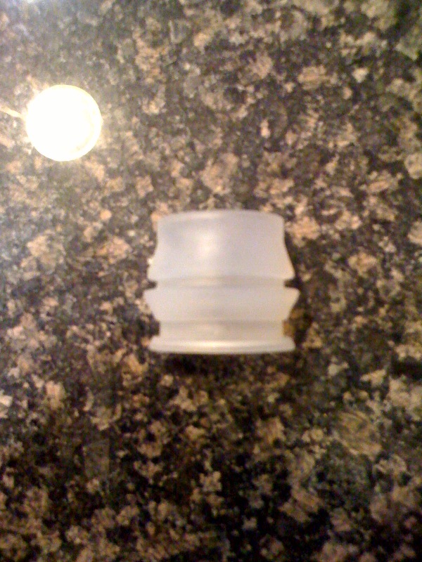

Postby Faron » 05 Wed Oct, 2011 10:43 pm
Is this what you are talking about?
Re: Pops outta 1st Gear
Postby GregR » 06 Thu Oct, 2011 6:18 am
Thats what I was talking about....and it's only one of several possibilities.
It's an easy and cheap fix that usually gets overlooked. Hopefully it'll solve or at least improve your problem.

Postby Bryan Porter » 06 Thu Oct, 2011 8:37 am
What did the one you took out look like?
Postby Faron » 13 Thu Oct, 2011 11:05 pm
It did not have one Brian, hence the question.
