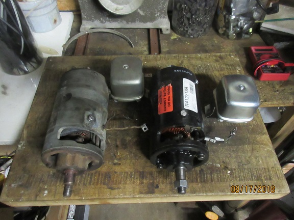

Postby johber41 » 15 Wed Aug, 2018 10:05 pm
Hello buggy family. Today was special! Today my buggy took a pshaw and stopped charging right before Roundup. What appeared to be a battery storage problem to me has turned into a failed generator. It is the original, so I guess I should not be complaining too much. But, COME ON, right before the Roundup. YouTube afforded me the tests I needed to determine if I had a voltage regulator problem or a bad generator. I tested the generator and watched it turn with a tad of 6v touched to the D+. It passed so I bought a voltage regulator. Nothing improved. I should be showing 7.2 v at the regulator output but instead it just mirrored the battery life at 6.4 v. I finally pulled the new regulator off and tested the output of the generator. The brushes looked good but I only got 0.2 v on my volt meter. Ordered the new one…$107.00 at Oreilly, and started pulling the engine. I am determined to make it to the roundup, car in working order. Don’t want the Doom Buggy award back! NO THANKS! Stay tuned….
Generator 2.jpg (74.44 KiB) Viewed 30157 times
Generator 1.jpg (113.7 KiB) Viewed 30157 times

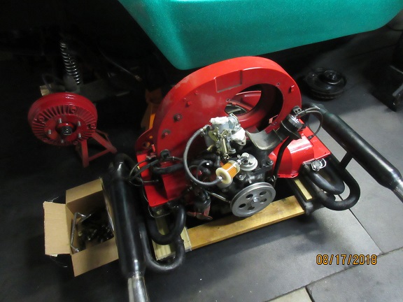

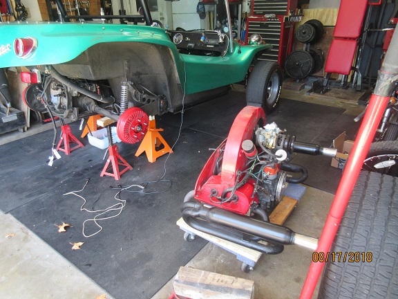

Postby johber41 » 17 Fri Aug, 2018 10:55 pm
Got the engine out and the generator removed from the fan shroud. Got the new parts in but the rebuilt unit has a sticker on it that states it does not allow a bench test. I like to see if the thing is working prior to re-installing everything. I might take it by a local rebuilder and see if he can test it for output!
Engine out Gen.jpg (140.71 KiB) Viewed 30122 times
Gener Out.jpg (96.93 KiB) Viewed 30122 times
New Parts.jpg (110.9 KiB) Viewed 30122 times

Postby johber41 » 21 Tue Aug, 2018 1:42 am
My car repairs are not living up to what I had expected. Installed the rebuilt generator and it has no output. What the &@?!. Going to have to pull the engine down one more time and seek out a better rebuild. All the polarizing etc has failed. You guys were right .......generators &@£*¥#%!!!!!

Postby johber41 » 22 Wed Aug, 2018 2:17 am
Hey Heath....I read about the dash light....I have never had one but I had a charging system. Who knows what they did on the initial build in 1966. I'll call you later today.....might need to use your generator.....a rebuilder in Baycliff has my original unit and he is evaluating it. I think the one I bought from oreillys was just a bad rebuild. I tried to get it to motor , turn when power added to D+ but it will not. They even have a sticker on it that reads the unit cannot be bench tested. When I asked the rebuilder in Baycliff about the sticker, he just laughed and wondered if they put that on there after someone wrecked it and brought it back. I'm pulling the motor around lunchtime tomorrow and then going to have the rebuilt unit checked by the rebuilder.
Interesting enough, when I start the car, it puts off interference that stops my smart tv from receiving it's wifi signal. So it's generating something, just not the right thing. Thanks for the bump Heath, and thanks for the info Ken.....I did check the unit and tried to polarize it several times. I think the unit is just rebuilt wrong.

Postby johber41 » 23 Thu Aug, 2018 1:22 am
I'm with you on that Bill.....the Oreillys unit had an extra lead for a brush ground that the professionals a A Alternators and Starters have never seen before. They tested the rebuilt unit and could not get it to do anything. I took it back for a refund and found an exact match for my old unit at Standard Auto Parts, now called Auto Plus or something like that. Will pick it up tomorrow. The future is getting brighter!

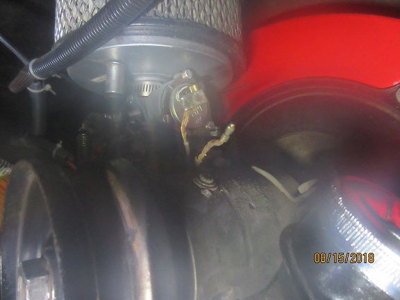

Postby johber41 » 25 Sat Aug, 2018 2:00 am
Spoke too soon.....back to the lab, had a fire under my dash that reduced amp gauge to a ball of molten metal and plastic. Nice little burn for sure.....have most of the wires pulled down but I am struggling with finding my tail light circuit. I need to figure out why the generator is flooding the system with all that amperage. My buggy is just not used to an efficient power source.....I'm sure my mechanical follies is wearing thin on readers......we will be there, maybe without the car!
