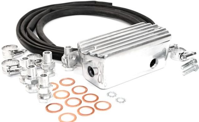

Regarding your question, is this (or something similar) what you are talking about? If yes, these are ran from the valve covers and oil filler tube to the breather box. No need to connect to carb filter.

Ken I’ve looked at probably all the types of “filter boxes” that one can purchase. The one you showed is the most economical one I saw. I haven’t decided on one yet, mainly because I haven’t got it strait in my head how it should work. I was reading a tech artical by Bob Hover, and seemed to say what I was thinking, that the valve cover would become the air inlet for the block. But, If the venting really doesn’t need to be ( or shouldn’t be ) ran to the carbs, it would make sense as you stated just run the three hoses to the box and call it good.

venting the case from the filler tube to the carb filter housing is the stock setup. Using a "breather box" omits the need for the carb filter housing connection, because you're using the box. Most people I've seen with breather boxes are using them specifically to prevent using the carb air filter. Some engines like to through oil through the filler tube vent all the way to the carb port. Sometimes to the point of performance issues because of the amount of oil buildup. The typical breather box setup, from the valve covers to box and from the filler tube to box, usually balances pressures between case sides sufficiently. All the other people I've asked install them because they look cool. And I agree they do.
what's your reason for venting? does engine leak? what weight oil you running?
