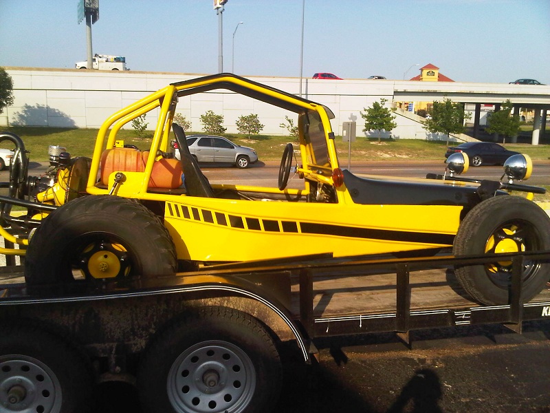

Bringing her home for the first time

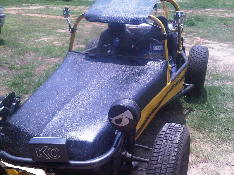

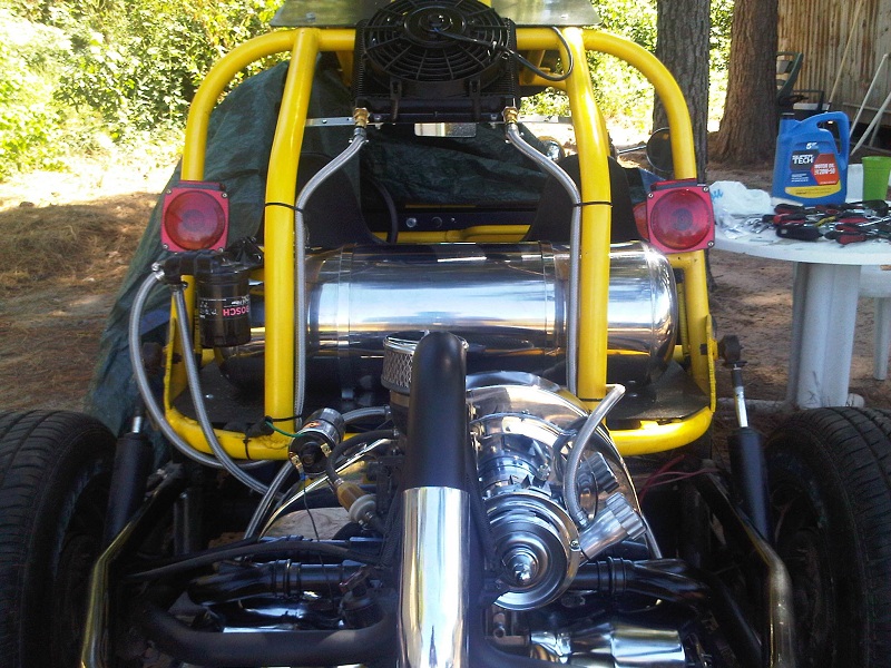

Postby RDCII » 03 Mon Oct, 2011 9:26 pm
Here just a quick update,
Swapped over to alt, got new shroud, tins, gas tank, repainted a few things, Rhinoed the floor.. messy job...lol
Heres a picture. Im hopefully going to be taking it to Texas Ren Fest the opening weekend coming up. If thats of course
I deam it Road Trip worthy....

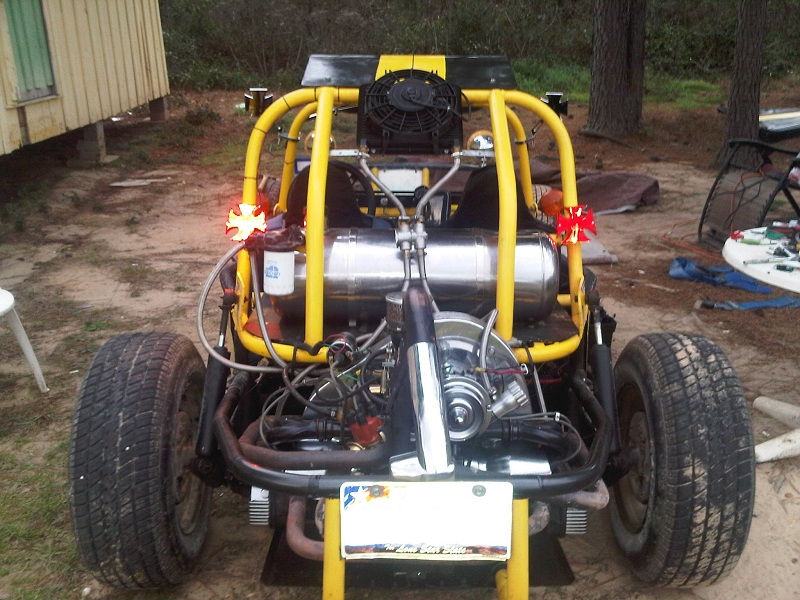

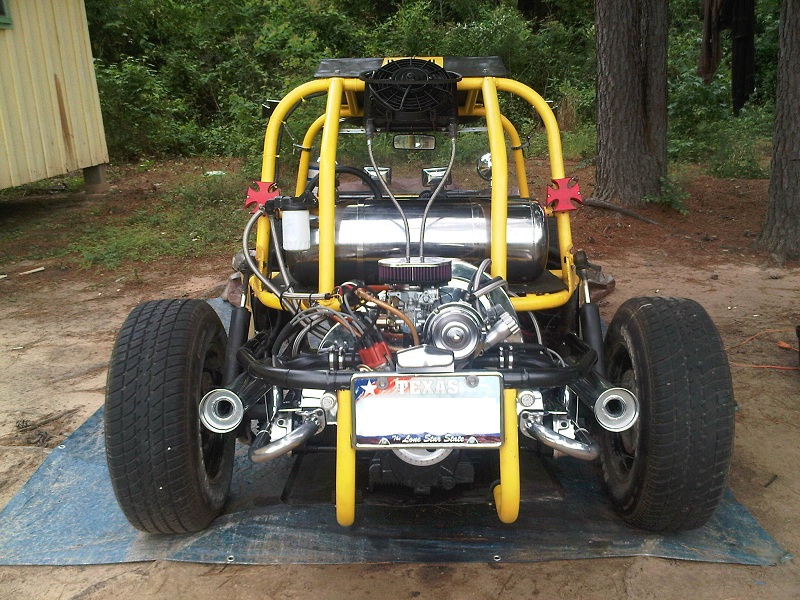

Postby RDCII » 05 Wed Oct, 2011 7:07 pm
Finished mounting my Cooler and running all the lines.
Updated Pictures
RDCII
71' Super Beetle Buggy
RDCII
Posts: 31
Joined: 08 Mon Aug, 2011 12:04 pm
Location: Trinity,Tx
Re: My "new" 71 VW Super Buggy
Postby BrianB » 06 Thu Oct, 2011 5:12 am
Is that fan pushing or pulling the air through the cooler? I imagine your right ear is going to toast if it is pushing.
Postby RDCII » 06 Thu Oct, 2011 8:21 am
It says its Reversible with equal Efficiency.
So I figure Ill have it Pulling outward doing the summer, and pushing toward me during the winter....
But you do make a good point... Guess Ill find out.

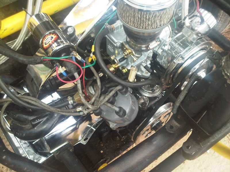

Postby RDCII » 31 Tue Jan, 2012 10:10 pm
Well I never really got time to go out and just have someone else get it running right for me, so every chance I got I researched, tried, failed, repeat and finally... I got it now. I had a 009 dizzy on there tring to get along with my new 34-3 carb. Ya they dont like each other...
So I finally got a Aircooled vac advance dizzy. Runs like a champ now. got a cheap timing light and got running pretty good. Carb still needs to be adjusted by someone other than me.. it tries to die when cold for the first min or so then it purrs at 800 rpms.
Persistence and determination paided of. I also got my clutch pedal to spring back. Wingnut was to tight. Got to take a 50 mile round trip ride yesterday, :D After almost a year now... Its almost done. or is it...Thinking of some dual mufflers system.. not sure which.
New vac advance dizzy and 34 carb

Postby Bill K » 31 Tue Jan, 2012 10:25 pm
Contratulations on your progress. Will we be seeing you at the VW Classic or for sure I hope at the Buggy Blast?
You are right, 009's and 34's don't get along very well. However, a 30-31 carb mated with a 009 runs great, but you have the problem solved with the vac advance distributor.

K been a while since I uploaded some pictures of progress.
Added some awesome maltesse cross taillights, Got some seat covers, new Scat T shifter with the reverse lock out.
Added a set of lights on the front to act as my brights, also some new covers for the lens.
I was running outta room for all my accessories on the ignition switch, so I ran a seperate positive,and negative to some junctions boxs. Ran outta wire covers. Still gotta tidey it up some more. Got the idea from on here I believe.
Heres the eye candy.

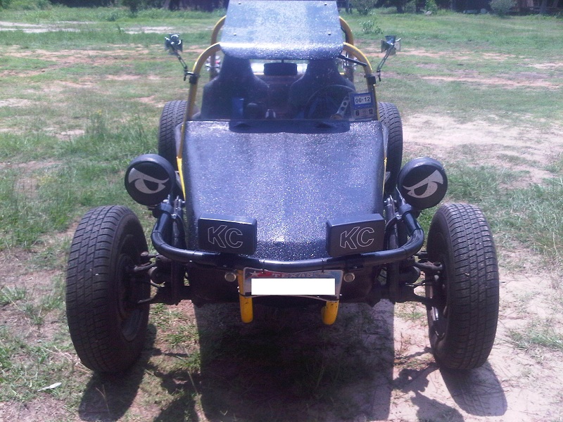

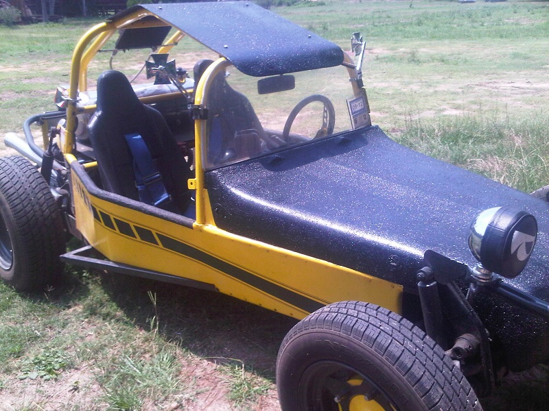

Well Ive been kicking around the idea of painting the buggy using Herculiner..Mainly the front and anywhere prone to bug/rock paint damage. After using it already on my floors, which at first were flimsly and flex to much..Now is soild, I knew this was the way to go. After 4hrs of prep and sanding, I spent the rest of the day laying 4 coats on the buggys front fiberglass cover, and the top. MAN... the front cover now feels like I can throw it off a bridge and not even faze it.
This stuff should last years, AS long as you prep right..
RDCII
IMG-20120608-00767 (2).jpg (237.25 KiB) Viewed 26756 times
Still debating on what to do with the sides. I have a few ideas....
IMG-20120608-00766 (2).jpg (223.5 KiB) Viewed 26756 times
Front View, not sure if im going to do the Bumper to or not...
