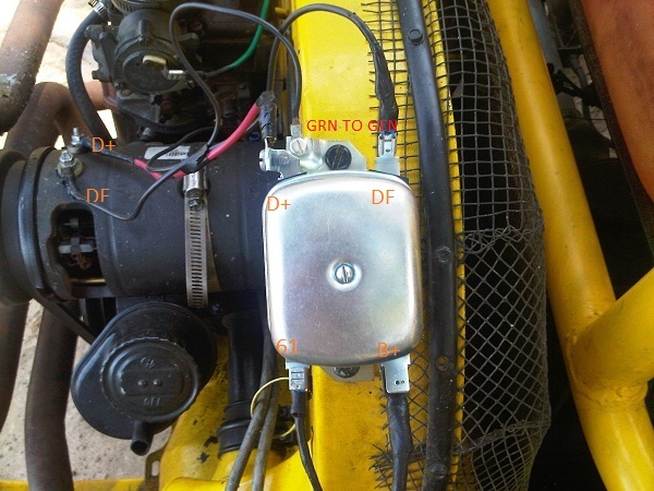

Here is a picture to show how I have it wired...
Thanks for all the help. Ive gone over so many wiring diagrams my head hurts...

61 from teh regulator does go to the "dummy" light. If light is in original location in VW speedo, I believe speedo housing acts as ground for the indicator lights. So sounds like that part is correct. Have you checked your wiring TO the regulator? Sounds like you having something hooked up backwards. The dummy light should act as an excitor to get the generator to charge.
In your picture, terminal Directly above 61 should be D+ and should connect to D+ on generator. Directly above B+ trerminal should be DF and should connect to DF on generator. What is wire that appears to be jumping DF and D+? Diagrams I've seen don't show that.

Im at a lost right now. heres a pic of the regulator again, this time with labels.
I dont have anything crossed or nothing just kinda looks that way cause there taped.
The little black wire inbetween D+ and DF is a ground wire coming from the little post on the generator toward the back.
Thanks for you input, wondering if just swapping over to an alternator would be easier... IDK..

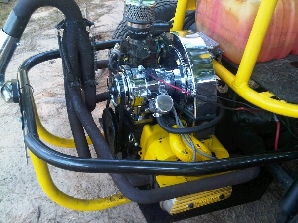

Recieved my alt/stand and new doghouse for Chirco.
Went on perfectly. Charges like a dream... So that helps reassure me
that I had it wired right, just got 3 defaulty gens in a row...
Thanks all for help, Im sure Ill need more in future.
