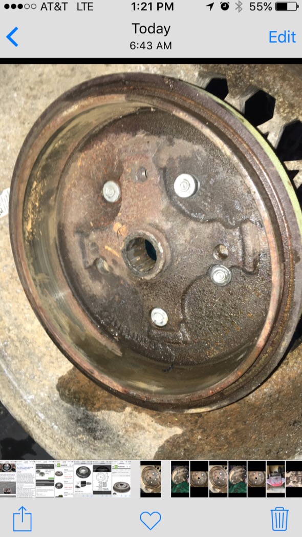

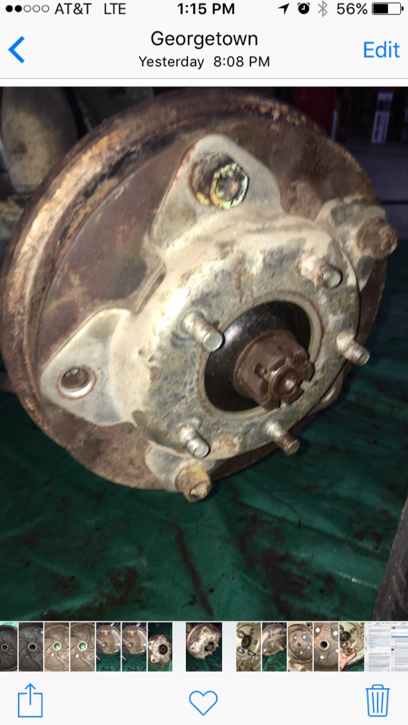

I bought a 1963-4 Manx style buggy and am in the initial stages of restoring it. I am new to this so everything is a little blurry right now and I have tried to do a lot of research on this topic but I just can't seem to get anywhere. Just keep going in circles. The problem I have is that (what I did not realize when I bought it) different wheels on my rear and both drums and lugs are kind of messed up. I also think I have two different kind/type/hole pattern or size of drums on the rear. On one side there is an adapter that allows a different mounting pattern and on the other the lugs are loose on the back of the drum. So, when I found this out I figured I could just buy me some new drums, mount some new wheels and move on. But now looking into it I have been told I have to make sure I get the right size drum for my year of buggy and make sure the size of it matches the drum brakes I have. I have no idea how to figure all that out and don't want to buy new drums for $90 each to find out they don't work with my drums and setup on my buggy. Also, will it then be hard to find a good choice of wheels for the 1963-4 bolt pattern?

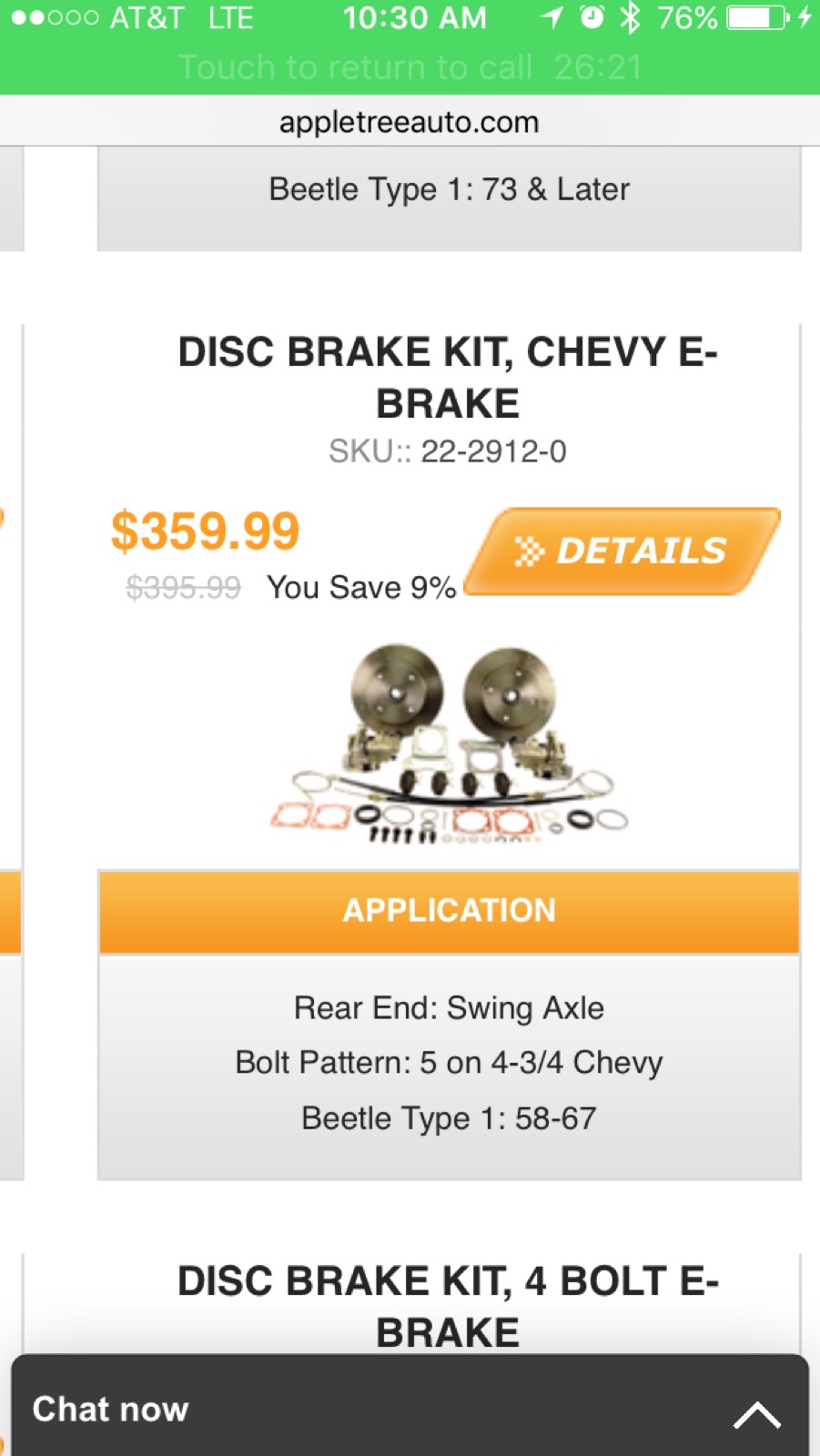

After doing some research I am thinking about converting everything to disc brakes. Just looked at appletreeauto.com and they have what's called a "Chevy" kit which gives you a better variety of wheels to choose from so you could do regular VW style and also more commonly found wheels like found online or around town (I thought that may save some money later on??). I posted a shot of one of the kits for the rear, but could not post the front disc kit as I can only upload 3 photos.

Now your brakes. You have what are called "wide 5 " drums. Used on earlier VW's.
VW's use lug bolts that run into a tapped drum. Not lug studs and lug nuts as are common on other cars.
The PO used an adapter, presumably allowing him to mount 5 lug rims in a Chevy or Ford bolt pattern. (4 3/4 or 4 1/2 bolt circle.)
I haven't seen adapters mounted quite like they are on yours. It appears they use a short bolt from the rear and then nut on the face. My concern would be if the tapped hole for the original lug bolt has been buggered up. So I think you're on the right track with replacing the brakes. Disc brakes are fine, I had them on mine. You could also go cheaper and replace backing plates, internal parts and drums. If you want to go with a Chevy pattern though I wold consider the discs, drilled for the Chevy 4 3/4 pattern. They can be expensive so look around at the different on-line shops (I know where are shops in Austin and San Antonio, just can't think of their names.) Shipping can be a monster too as they are heavy.
