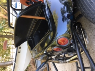

Hello all,

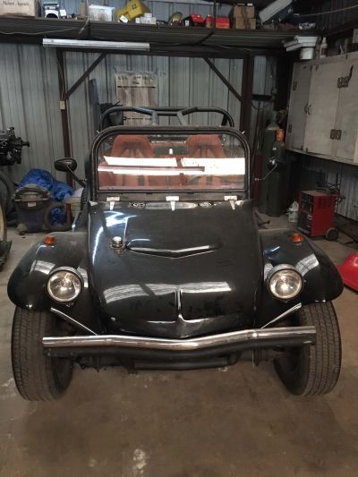

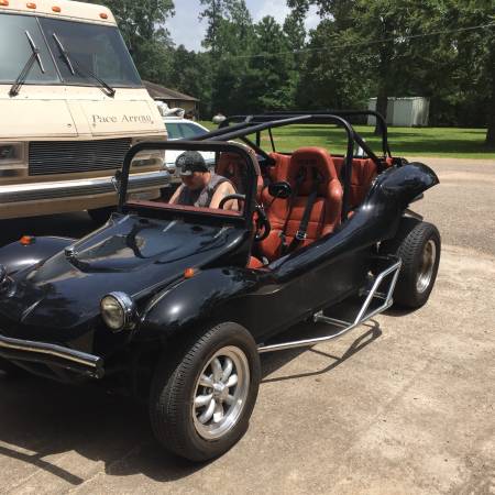

I'm in the process of purchasing a buggy with fiberglass body. Trying to find out more about it, manufacturer, when built, etc.
I attached an image of it to see if anyone knows about this particular body. I looked on the ID page and may have narrowed it down to
a JSC (Johnny's Speed and Chrome Shop). Located in California I think but not sure if this is right.
Looking forward to meeting some of you and getting to know more about buggies.
Tappa

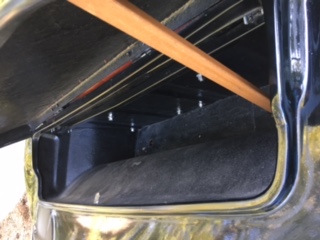

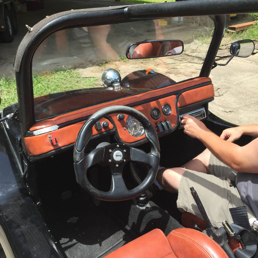

Here it is from the front. The trunk lid is functional, the dash is created by steel tubing with inserts, It has a small storage compartment behind the back seat accessible with a hinged lid. The back edge of the body is upswept and houses the tail lights, tow round recessed lights on each side.
Tappa

Welcome to the Texas Manx Club. Nice looking "bettle" you found there. So you just missed a great get together last weekend in Kerrville. Where are you located?

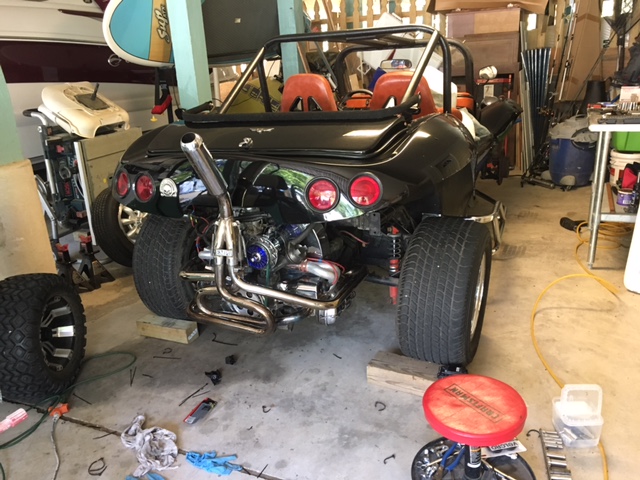

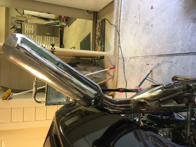

I'm posting another pic.

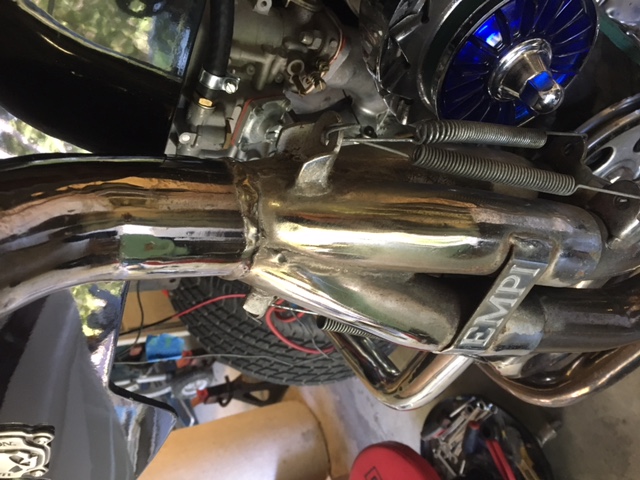

Engine compartment
Tappa

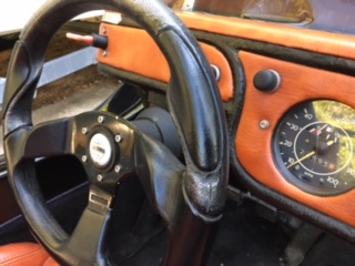

side view
Dash

Postby johber41 » 10 Sun Sep, 2017 10:59 pm

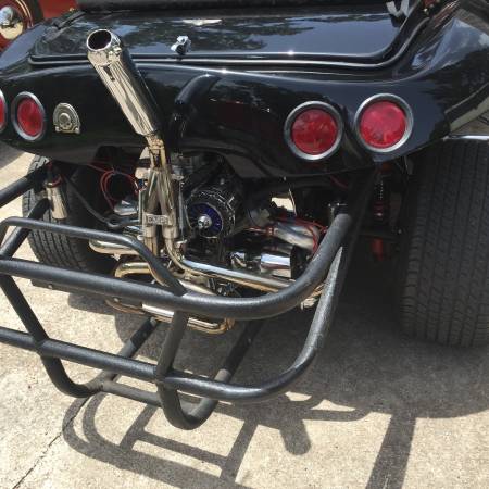

That rear engine cage looks excessive.....might be able to cut it down a bit to make it closer to the engine.....looks like a fun project
Re: New to site and buggies
Postby Tappa » 11 Mon Sep, 2017 6:24 am
Hello John,
I bought it yesterday and drug it home last night. I was out in the dark messing with it
until 11:00.
I agree with you. It seems to protrude way out in the back. I don't see any reason for
it to be that long. The only thing I could think of was room for a different exhaust system.

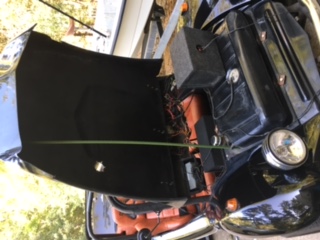

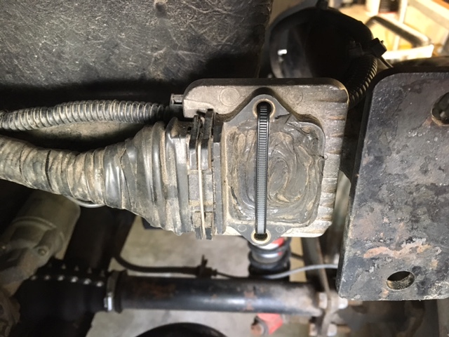

Well, I bit the bullet and bought a project. I've been mostly cleaning it up today and checking a few things out.
It doesn't seem to be charging the battery so I need to check the generator and the regulator but I can't locate
the regulator. I also noticed the vacuum line was plugged on the distributor and I don't know why.
It has a two barrel carb which seems to be loose which I'm assuming is causing a vacuum leak and poor running
at slow speeds. If you put your foot in it, it will go, but if you ease down the throttle it seems to stumble.
Don't know if this is due to carb adjustment or a possible vacuum leak.
I'm adding some pics.

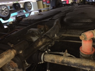

Postby Tappa » 11 Mon Sep, 2017 11:25 pm
Tomorrow I'm going to check compression and valve lash to make sure the internals are in good condition.
Then I 'll check out the generator output and regulator. It has a 1972 chassis which seems to be in good shape
with a solid floor pan and suspension as far as I can tell.

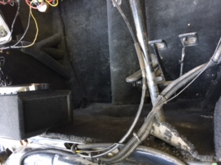

question:
1. The clutch and brake pedals seem to have quite a bit of free play before hitting any resistance which is bothersome.
Can this be adjusted so the pedals are lower to the floor?
Not sure why the pics are upside down and sideways, Oh well.
gas tank and access to under dash
pedals
transaxle

Postby Tappa » 13 Wed Sep, 2017 4:04 am
I adjusted the clutch cable and the brake rod which brought the pedals up to a comfortable level but I think I
created a problem with the front disc brakes. They are dragging and not releasing all the way. From my research
It seems that I adjusted too much play out of the pedal. Does that sound right? I still have a good two inches or better of travel
before any resistance. I took it for a test drive and before I got home the right front brake was making the car pull
to the right and it was really hot. Any ideas?

I agree , I believe you have a JSC Buggy.
What kind of master cylinder do you have? Single or double? More than likely it is double. When you adjust the brake you should actually have an inch or so gap between the brake pedal and the master cylinder piston rod. Not necessarily when you feel pressure. You need that gap because as the brakes heat up they will expand and if it it to tight they will drag. During my build I found a wheel cylinder that would stick and it drove me insane for about two weeks. Is your brake pedal really tight when you press on them? I am hoping to help you get it road ready so you can make Brenham.

Thanks Heath, JSC is the closest thing that I can find although mine has a trunk for storage and the hood opens to allow access to the gas tank and backside of the dash board and floor area ahead of the front seats. The only drawback I can see, is that when I washed the car for the first time I got water in the floorboard and had to dry it out. I think I can remedy this with addition of some weather proofing gasket material placed in the right spots.
Actually have a single master cylinder, with discs on the front and drums on the rear. Yesterday I found that the driver's side caliper was bad and not applying
any force to the disc and the other side was staying engaged and getting really hot. The master cylinder was also leaking back into the floorboard. I pulled all of it out and ordered new calipers, brake lines and master cylinder. I wanted to go to a double master cylinder but not sure if it will work as I only have one hardline feeding the rear brakes and not sure if I can plug one outlet on the master cyl. What do you think? I don't want to create a problem.
Thanks for the information and looking forward to meeting some of the great people in this group.

I'm posting a few pics of the engine compartment without the cage. One thing I relocated was a small flat rectangular shaped thing with a large wire connector plugged into it. Anybody know what that is? or if it need to be grounded to the frame in some way?
I like the way it looks without the cage but I may cut the old one down to make it look better and put it back on more for protection and a place to hang the license plate.
Without the cage
Flat box with connection?
Tappa
Posts: 60
Joined: 06 Wed Sep, 2017 6:58 pm
Postby Bill K » 15 Fri Sep, 2017 9:55 am
I agree, it looks much better without the cage.
Postby Tappa » 15 Fri Sep, 2017 10:16 am
Bill K wrote:I agree, it looks much better without the cage.
Thanks Bill, I haven't decided whether to leave it off entirely or cut it down and redesign it so it doesn't detract from the overall look.

Postby Tappa » 17 Sun Sep, 2017 5:10 pm
Posting a pic or two of my muffler and collector. I'm thinking of cutting the muffler off and welding a turbo muffler in it's place but adding some pipe with a bend in it to point the muffler toward the ground.
Collector
Stinger muffler
Tappa

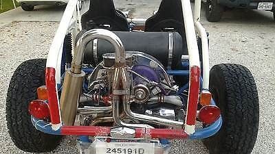

Postby Tappa » 18 Mon Sep, 2017 1:15 am
I finally found a picture of what I want to do with the exhaust. The only difference is I may use a turbo type muffler.
Wanted
