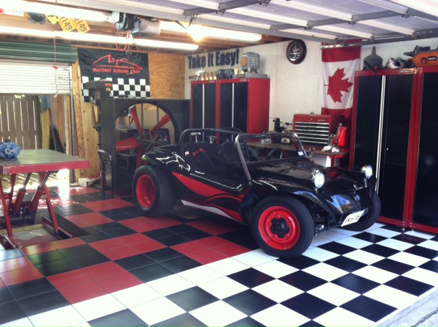

Postby BrianB » 02 Mon Feb, 2015 3:03 pm
Thank you. here is a better shot of it
garage with schumacher.JPG (145.52 KiB) Viewed 156166 times
