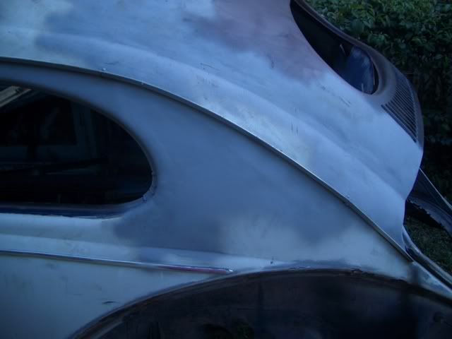

Postby Texasbuggys » 03 Tue Jun, 2008 8:55 pm
Little more progress, lot ya can't see from the pictures but done. Here is the front windsheild surround welding back and almost finished, just a bit more "working it" to do.
Then a little quarter window work to get them just right! Going for the stock squasshed look, I think we are there fella's now to fill re-shape and make it look purdy!
Postby Texasbuggys » 05 Thu Jun, 2008 9:40 pm
More ZIT ZIT ZIT going on! Roughed in A pillar
Postby Texasbuggys » 05 Thu Jun, 2008 9:41 pm
shaping up the rear quarter window
Postby Texasbuggys » 05 Thu Jun, 2008 9:47 pm
Inside getting roughed in
Postby Texasbuggys » 05 Thu Jun, 2008 9:49 pm
what ya think? Still have the door tops and some more stuff
