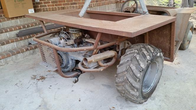

Postby johber41 » 18 Sun Jan, 2015 12:33 pm
Got this mechanical beauty at an estate sale.....$150 worth of 1960 VW bus parts including a Type 3 Engine and a lot of steel.

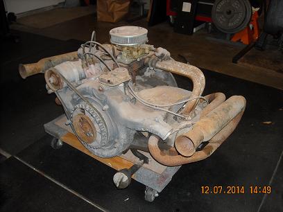

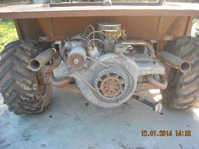

Postby johber41 » 18 Sun Jan, 2015 3:32 pm
Took the bumper and engine cage off...everything heavy steel construction. Better look at the engine.

Re: Check This Deer Lease Machine
Postby staggerwing » 18 Sun Jan, 2015 9:14 pm
Cammo? Does it run?
Postby johber41 » 18 Sun Jan, 2015 10:50 pm
been sitting for about twenty years....the engine turns over and there is fairly clean oil in the crankcase...I am unfamiliar with this pancake style engine, but it is my understanding that the fan is the only real difference. The block is the same as the type 1, so once I learn the assembly, the rest should be easy. The drive train is from a 60 bus, but the pan looks like it was from a beetle. The intake is dual port, so the block may be a 1600 cc or so. Its an adventure! Stay tuned!
Postby Bryan Porter » 20 Tue Jan, 2015 11:58 am
With the gear reduction trans that thing could plow your garden. :D :D :D

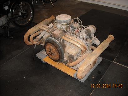

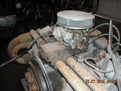

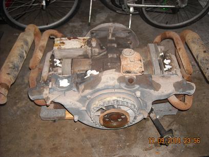

Postby johber41 » 24 Sat Jan, 2015 3:47 pm
Engine is out.....interesting enough, no leaking, turns over, and you can hear compression. I believe everything is 6 volt, so I am familiar with that. Something to wrench on for late evenings. It is the medicine I need to relax after work. Hey Bryan Porter,the swing axles don't just go from the trans to the backing plate, there is some style of gear reduction at the backing plates...I will try and add a pic later. Check out the home-made intake system....carb is too dirty to identify yet. 3 more pics for you guys to see.
Front 3 Red.jpg (149.31 KiB) Viewed 61284 times
Rear Red.jpg (148.71 KiB) Viewed 61284 times
Intake Rear Red.jpg (155.37 KiB) Viewed 61284 times
Postby johber41 » 24 Sat Jan, 2015 5:28 pm
Looks like gear reduction at the wheel.
Rear Reduc 1 red.jpg (155.2 KiB) Viewed 61280 times
Postby Bryan Porter » 25 Sun Jan, 2015 12:48 pm
Yes gear reduction boxes
carb is progressive 2 barrel
type three intake made to go under floor of station wagon
is starter and gen. both 6 volt?

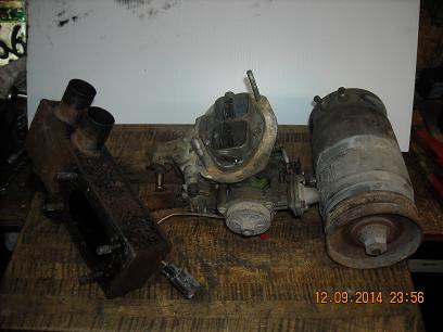

Postby johber41 » 28 Wed Jan, 2015 12:50 am
Have the intake and the generator removed. Block looks good, intake portals are clear.

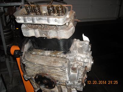

Postby johber41 » 03 Tue Feb, 2015 8:36 pm

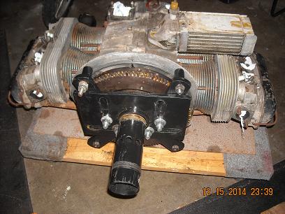

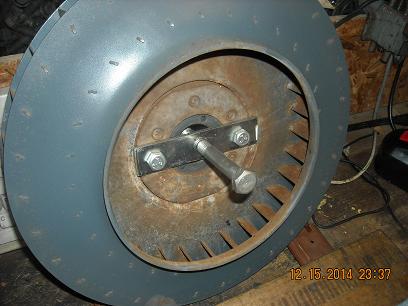

Finally have the engine ready for the stand...turns out it is a "u" block, 1600cc. Had to utilize my tap and die kit to build a fan puller. Pressure washed the block and it seems like it is in great shape. Once I get my neighbor to help me lift it to the stand, I will pull the heads and investigate further.
Postby staggerwing » 04 Wed Feb, 2015 10:02 am
Looking good John!
Any plans for the machine once you get er up and running?
Send some of that enthusiasm my way so I can get motivated fixin stuff on the buggy!

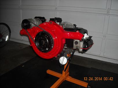

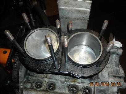

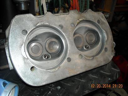

Postby johber41 » 06 Fri Feb, 2015 10:18 pm
Block looks good...going to freshen up the cylinders, get some push-rod tubes, re-assemble, and see if she will fire.
Cyl Polish red.jpg (152.73 KiB) Viewed 61326 times
Head Polish red.jpg (151.49 KiB) Viewed 61326 times
Waiting Tubes red.jpg (152.51 KiB) Viewed 61326 times

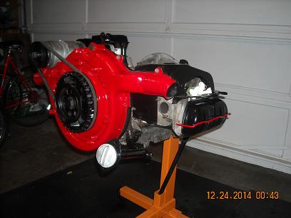

Postby johber41 » 10 Tue Feb, 2015 9:25 pm
Almost.......rebuilding the intake with fresh connectors and a clean carb. I want to build an add-on for my engine stand that would allow me to start the engine while on the stand. I have seen the engine stands people make with the partial bell housing, but without the trans to sacrifice, have any of you skilled builders found a way to simulate the mount for the starter?

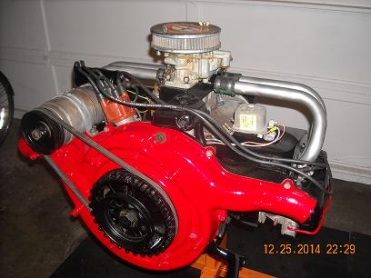

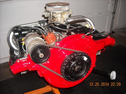

Postby johber41 » 14 Sat Feb, 2015 11:24 pm
Getting closer to the video Ken! You were right Bryan Porter.......the starter is 6V and the generator/voltage regulator are both 12V. I guess the builder married the 1960 pan-trans-axle to a more modern engine.
Intake on 2 red.jpg (151.89 KiB) Viewed 61547 times
Intake on 1 red.jpg (152.11 KiB) Viewed 61547 times

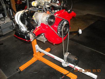

Postby johber41 » 21 Sat Feb, 2015 1:26 am
Thank goodness for the front pulley......figured out how to start it on the stand. Making use of an old table saw-gear reduction motor and a lever.
Front Start 2 red.jpg (153.37 KiB) Viewed 61536 times
Front Start 1 red.jpg (147.27 KiB) Viewed 61536 times
Postby johber41 » 21 Sat Feb, 2015 1:49 am
Postby staggerwing » 23 Mon Feb, 2015 10:03 am
THAT'S JUST NOT FAIR! I'm at work and I can't watch this video till I get home cause they have Facebook blocked? I quit.. Well, okay, I won't quit, at least not today. It'll be the first thing I do when I get home though!
Good job on the rigging John! There's no way I could have come up with anything like that to make it work.
Postby johber41 » 14 Sat Mar, 2015 8:43 pm
Thanks Richard.....Hey Ken, here is the start up video on the Type 3.....started first rotation,its a weird version though with the distributor 180 degrees reversed and the Holley-Motorcraft Ford two barrel carb. Getting the carb rebuild kit was the hardest part.
Postby johber41 » 17 Tue Mar, 2015 10:35 pm
Going to keep it as a spare....runs great, just weird in the settings. The stand was plenty strong to support the start up.
