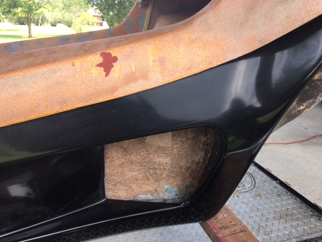

"Das Black Beauty" "68 Manx Project Underway (side pods)
Postby Das Li'l Beast » 22 Fri Jul, 2016 3:26 pm
Myers Manx fluted side pods cost me more including shipping than I spent on the entire tub. Had to have them, and Winnie took a couple of weeks to get them out but they did arrive in good condition. They fit sort of O.K. but will need more work to glass to the tub and then work on install of custom stainless steel mesh or the vent openings.
Manx side pods.jpg (122.17 KiB) Viewed 13093 times
