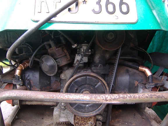

Postby staggerwing » 11 Tue Dec, 2018 11:07 am
Very cool, John! I love those copper elbows on the risers. You sir, are on of those guys that can think outside the box, which is something I struggle with.
Re: Intake Manifold Saga
Postby johber41 » 11 Tue Dec, 2018 3:54 pm
Thanks Richard...that was a quick fix back in 2008 when I did not even know what they were needed for. Back then I just thought it was something needed to start the engine. Eventually I removed them from the intake, welded the holes in what was left of the intake and used it like that since. Now I am going to give then engine the use of the heat risers to maybe stop some of the hesitation in my acceleration.

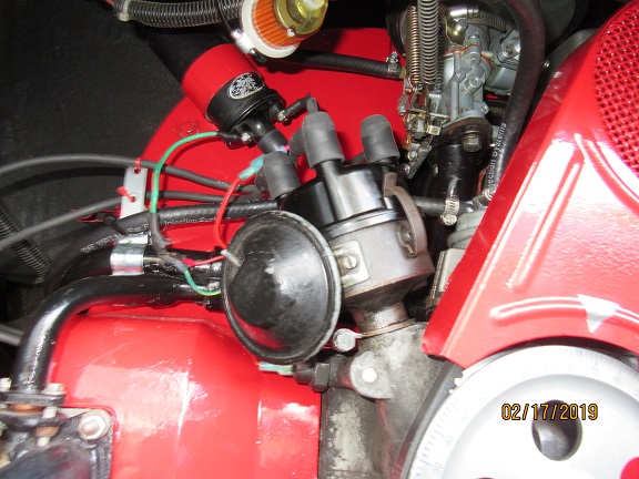

Postby johber41 » 18 Mon Feb, 2019 2:00 pm
Back on the buggy since I have been able to escape the winter vortex in Michigan for a while.
Started with obtaining a new main jet, 120, for my PICT 30 Empi carb. I purchased 120 and a 117.5. I'm going to see if I am thinking this correctly.
When I first received the buggy, it had on-board all OEM equipment from 1961. As the years went by, I have tried to improve with introduction of a PICT 30 carb over the worn and leaking PICT 28.
I changed the distributor from a big-cap with vacuum advance to a .009.
I believe my better option is to move backwards now by replacing my distributor with the rebuilt big cap. Then I rebuilt the vacuum line to the carburator adding a steel line with the reverse P-trap. I replaced the bad main jet with a new 120. I have a 117.5 just in case it needs to be down sized for the 1200.
Lets see what happens.

Postby johber41 » 24 Sun Feb, 2019 1:34 pm
In conclusion.....went OEM as much as is possible. I have had a positive result and drove the heck out of it on Saturday including cruise night in Kemah. Ran great and electrical system was healthy and flawless with constant and even charging. I can tell the generator is a success due to being able to shut the battery off while running and still run the car with the lights without fail.
The new intake with a corrected heating tube seems to be helping. I at least know that there is no breech or vacuum leak.
The Bosch big-cap distributor has evened the engine out and though it might not be as peppy as it was with the .009, it is not hesitating. I have it timed at 10 degrees BTDC as is listed in the manual for the 1200 40 horse.
New wires and plugs...everything good. I even had it over 60 mph, which was always a stretch in the past.
