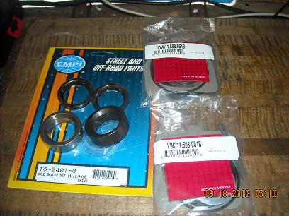

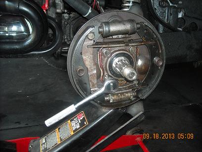

Once again, I changed the seal out with a new kit but this time I also changed out the spacer. I have my fingers crossed.
Remove Seal Carrier.JPG (66.07 KiB) Viewed 8239 times
New Stuff.JPG (68.57 KiB) Viewed 8239 times
