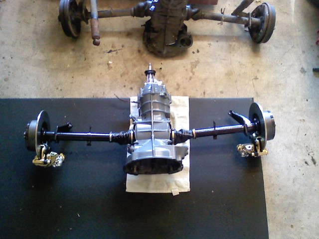

My Current project, its gonna be a "Hot Rod Buggy"
Complete transaxle rebuild and disc brakes added.

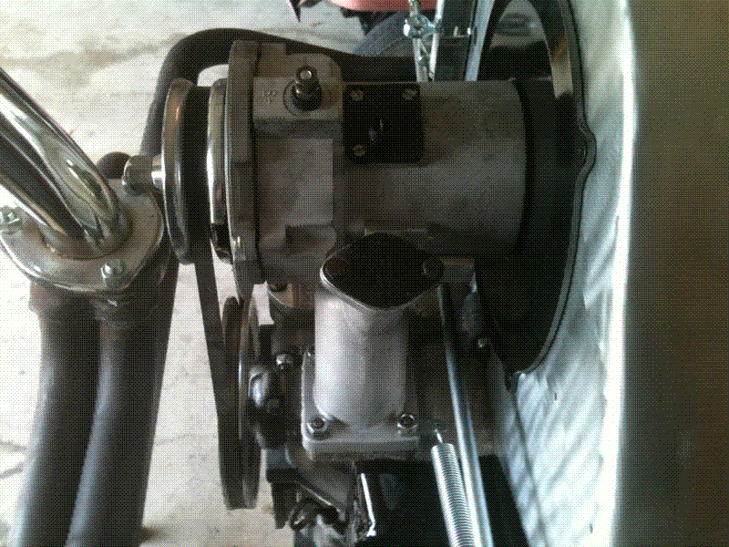

Some progress pics on the motor part of the build.
Fabricated/Modified the stock linkage that came with the new kadrons. Disassembled an ALT to blast the housing and re-surface the commutator and brushes. Fabricated an Oil filler cap out of scrap metal for the Feuling oil filler neck. Bolted up this exhaust so Id have something on it when I get ready to fore it up next weeked. Id like to trade out this exhaust for some megaphone exhaust that is wide enough to run dual carbs.
